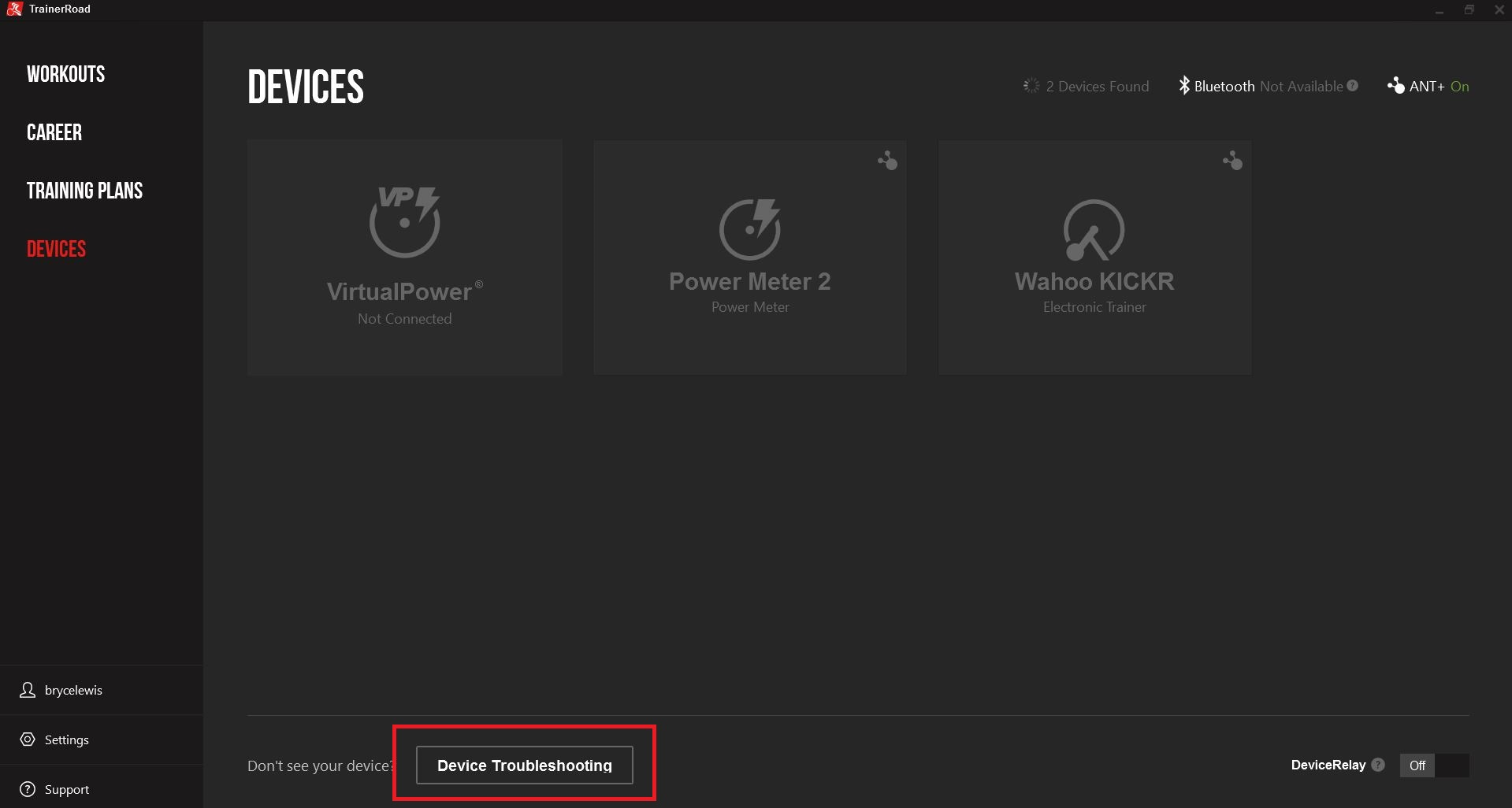

- Go to the Devices section of the app
- Plug in your ANT+ stick
- make sure it displays ANT+ as On in the upper right corner of the screen

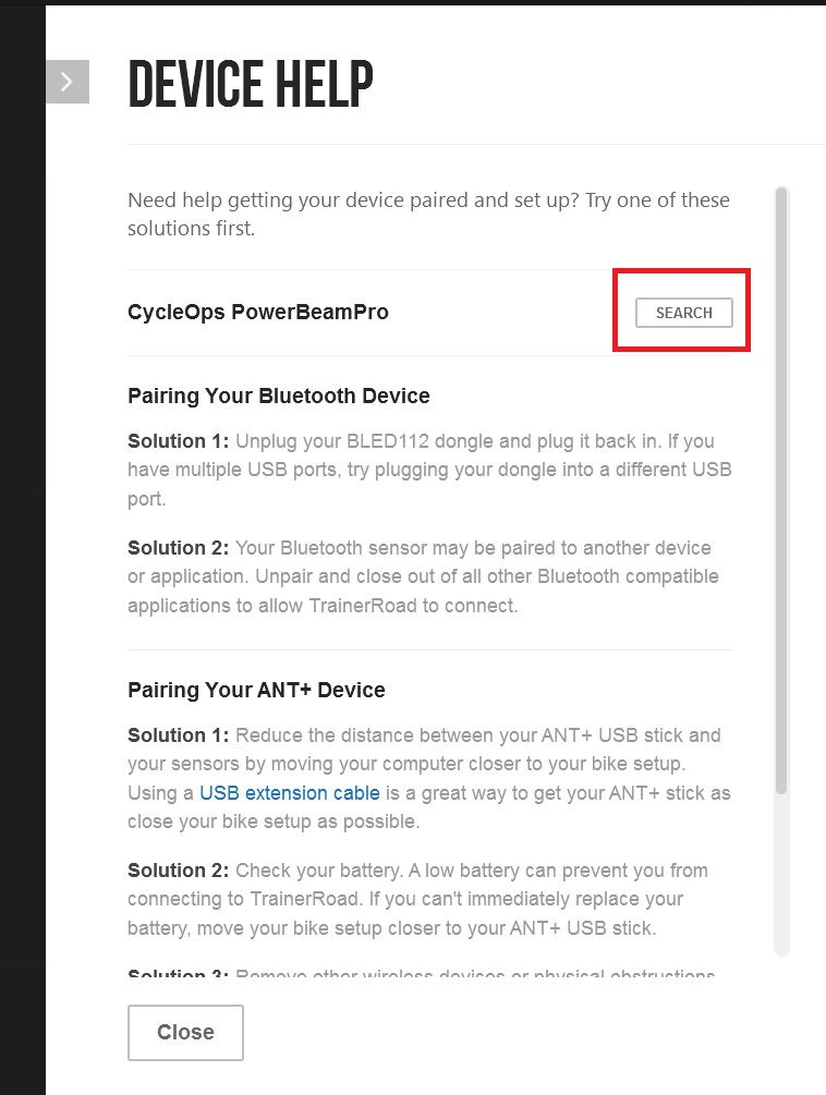

- Click Device Troubleshooting at the bottom
- Click Search next to the PowerBeamPro
- Click Pair when the PowerBeamPro is discovered

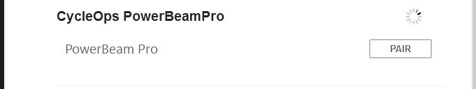

Step 4. Search for devices.
After your ANT+ USB stick is connected, you should see the screen below. Scroll down to where you see the PowerBeam Pro listed, and click "Pair."
If you have an older Power Beam Pro, clicking "Pair" may not be successful. If this is the case, you can connect with TrainerRoad by clicking "Legacy" instead of "Pair."
