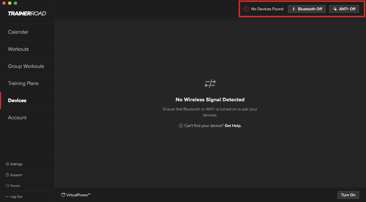

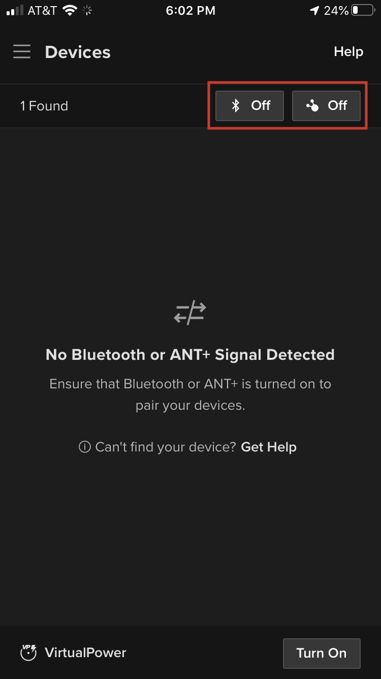

Problems with Bluetooth Smart (4.0) Detection
If TrainerRoad can't detect your Bluetooth Smart (4.0) devices on your computer we have an article that will help you with the system and hardware requirements.
Bluetooth Smart (4.0) Requirements
Problems with ANT+ USB Stick Detection
If TrainerRoad can't find your ANT+ USB Stick we have a troubleshooting article to help you get going.
ANT+ USB Stick Troubleshooting
