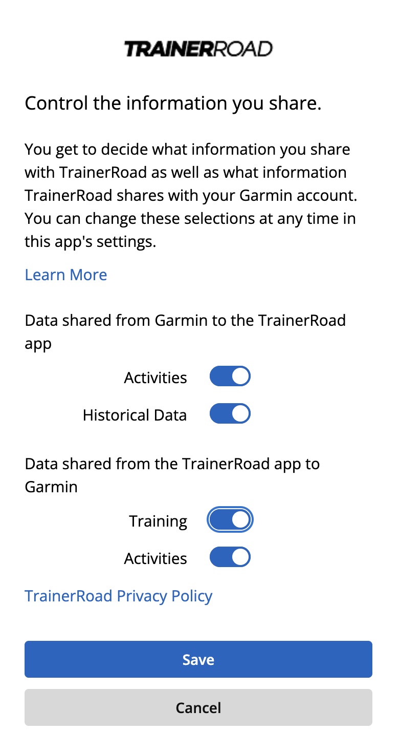

Authorize Garmin Sync
To allow outside workouts to push to Garmin Connect, set up Activity Sync to include pushing workouts from TrainerRoad to Garmin. If you have previously set up Activity Sync, you will need to re-authenticate to enable this.
Allow TrainerRoad to share data with Garmin Connect by enabling all the toggles.
  • Note; the "Historical Data" toggle is disabled by default. Manually enable it for your training history to sync to TrainerRoad.
