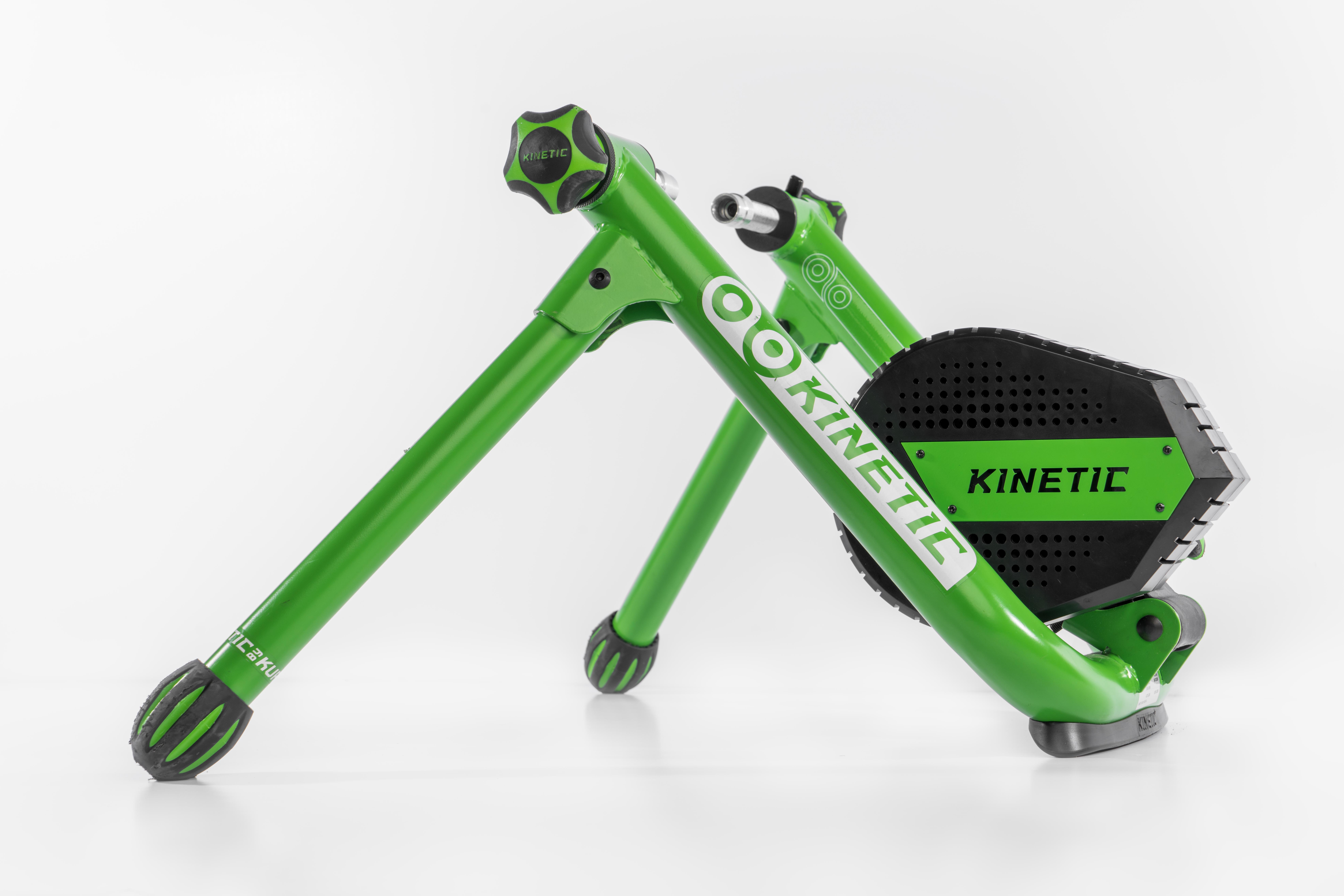

The Kinetic Smart Control is a resistance control unit that connects directly to your Kinetic Rock and Roll or Road Machine trainer - turning it into a smart trainer. The unit can connect to TrainerRoad via Bluetooth Smart. TrainerRoad can automatically control the Smart Control's resistance in accordance with the workout's profile.

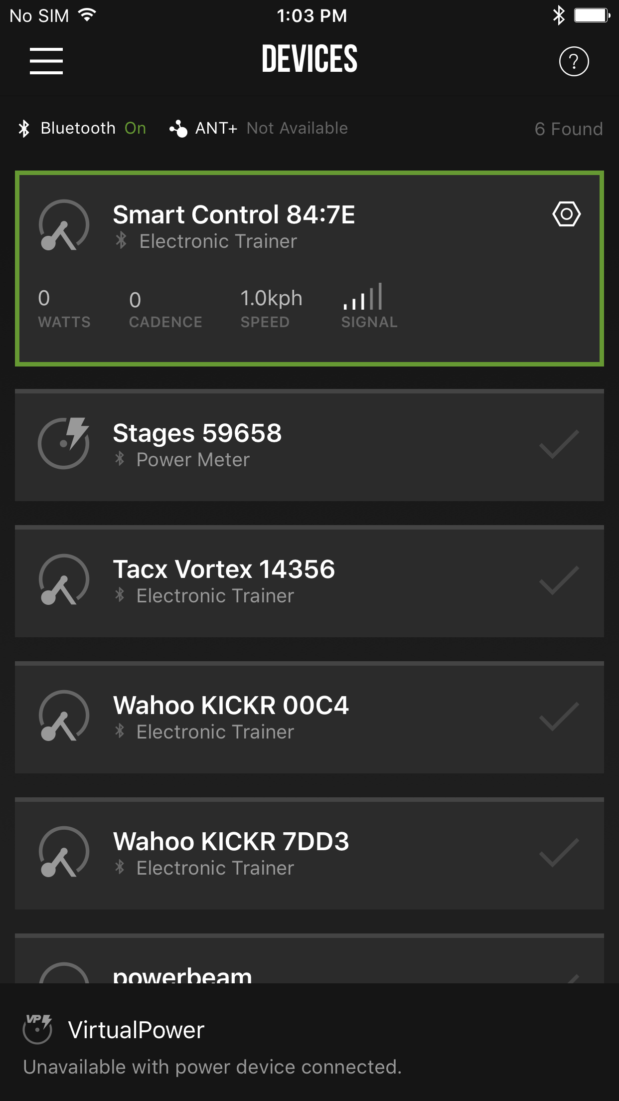

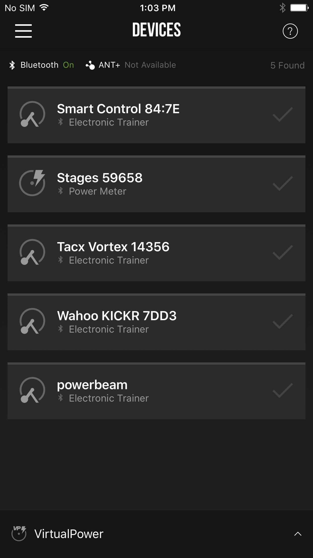

1. Open the TrainerRoad app and go to the Devices screen.
Make sure your phone's Bluetooth is enabled and your Smart Control is plugged in and awake. Currently, the Smart Control can only be paired to iOS via Bluetooth 4.0.
Note: ANT+ support is not available for the Smart Control.
2. Tap the Smart Control option to initiate the pairing process.
Once paired, the grey square will be bordered in green.

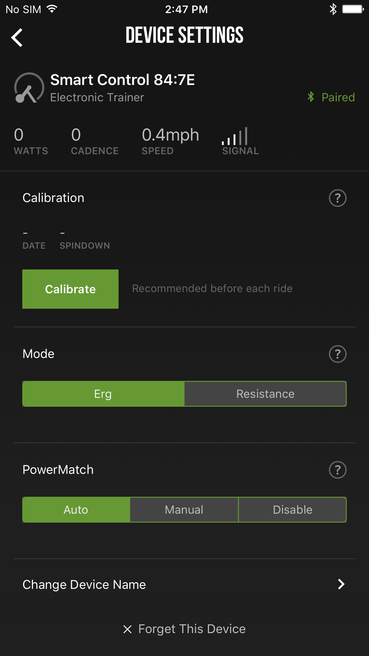

3. Tap the Smart Control once more to open the Device Settings screen.
From here, you can perform a spindown calibration, rename the device, select the trainer mode, and specify PowerMatch options.
4. Perform a Spindown Calibration. Tap "Calibration" in the Device Settings screen. Now you're ready to ride!

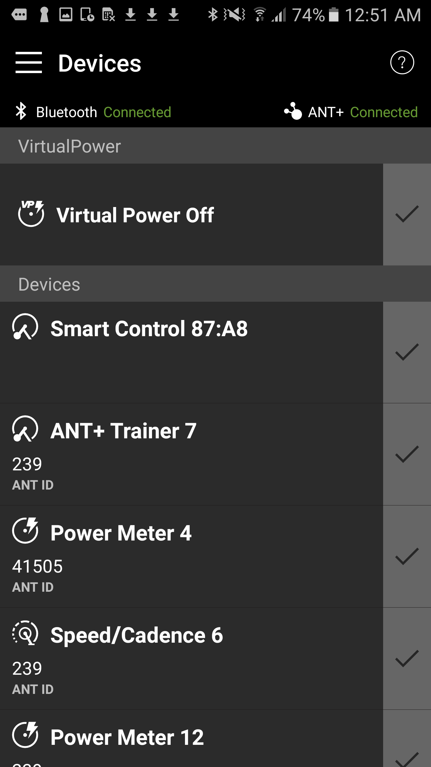

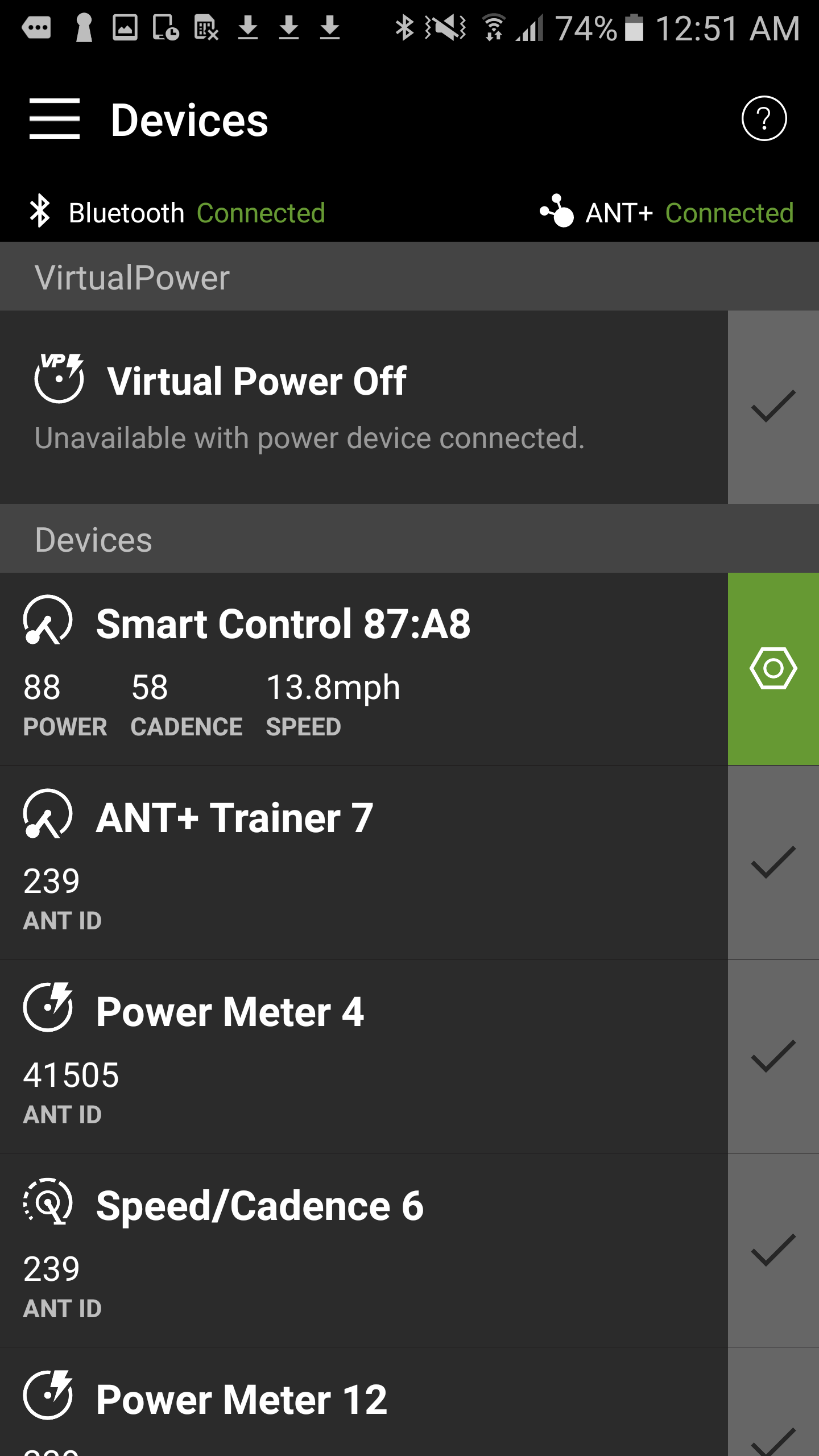

Make sure your phone's Bluetooth is enabled and your Smart Control is plugged in and awake. Currently, the Smart Control can only be paired via Bluetooth
4.0. ANT+ support is not available for the Smart Control.
Once paired, the grey square on the right will turn green.

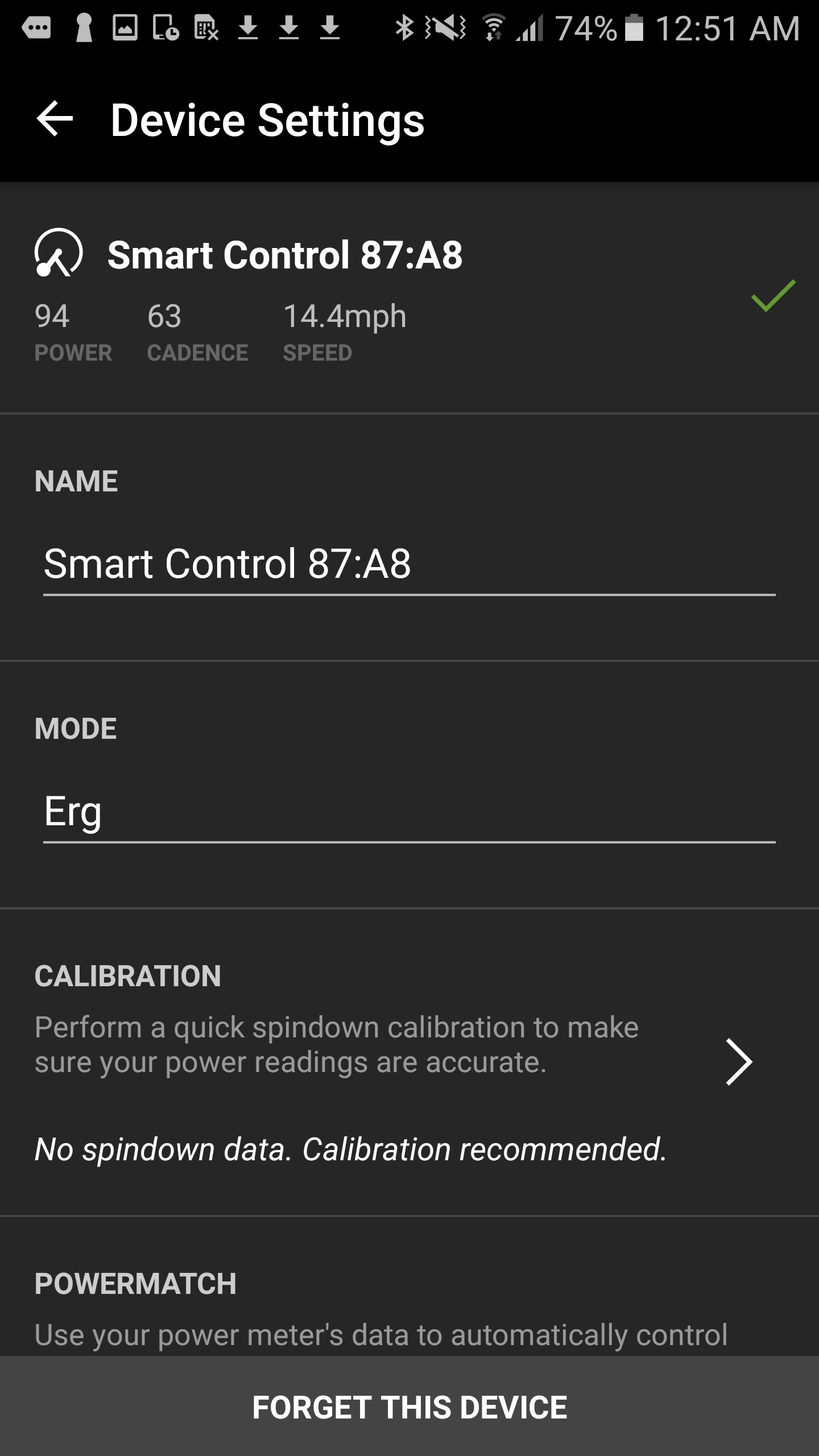

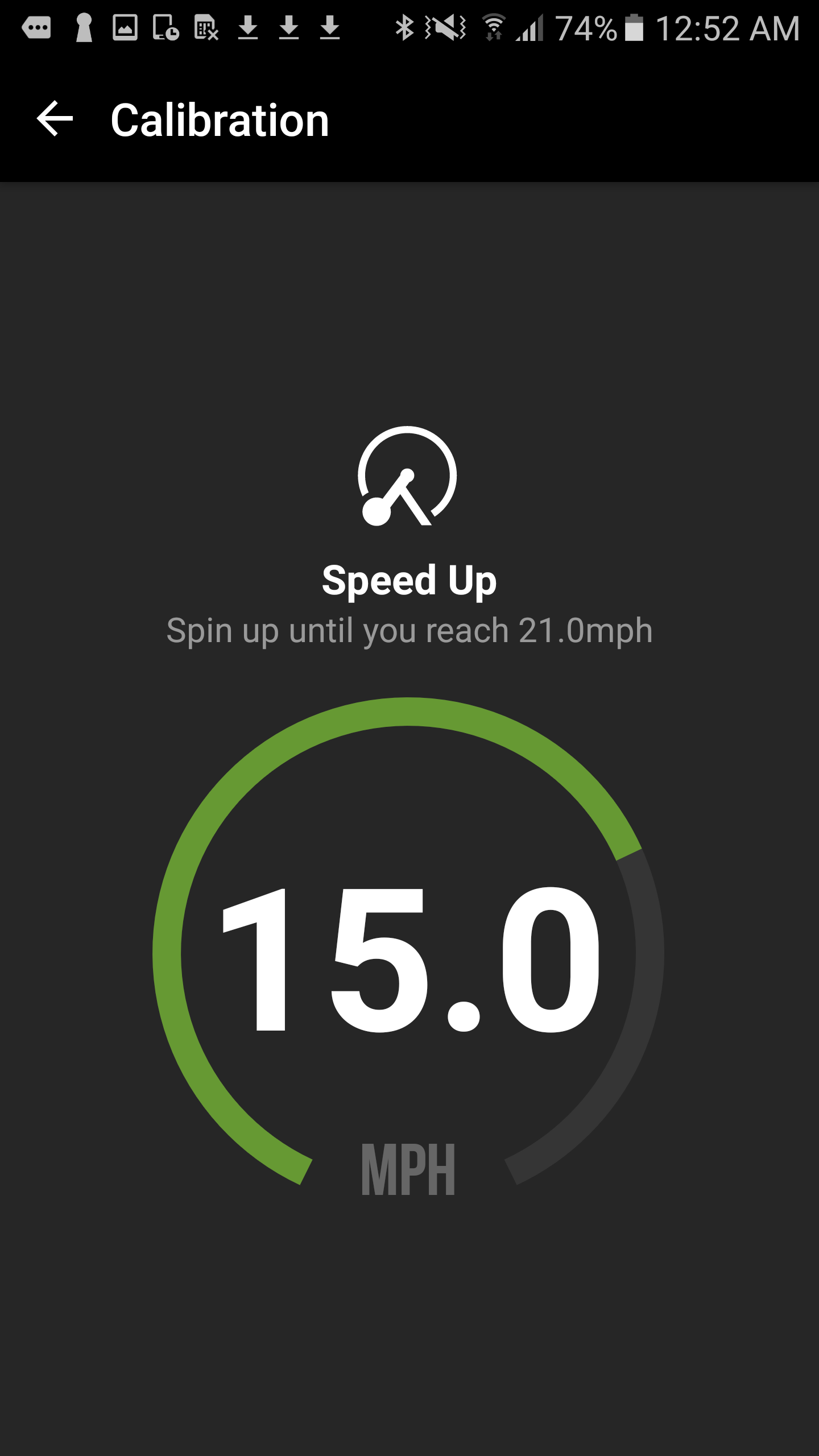

From here, you can perform a spindown calibration, rename the device, select the mode, and specify PowerMatch options.

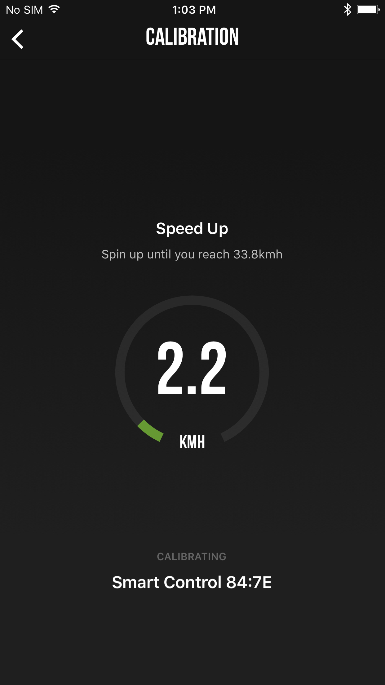

What do I do if the Spindown Calibration fails?
When performing the spindown calibration, try bringing your speed up past the target speed by a few kph/mph. If you're struggling to bring your speed up, you can shift into a bigger gear.
