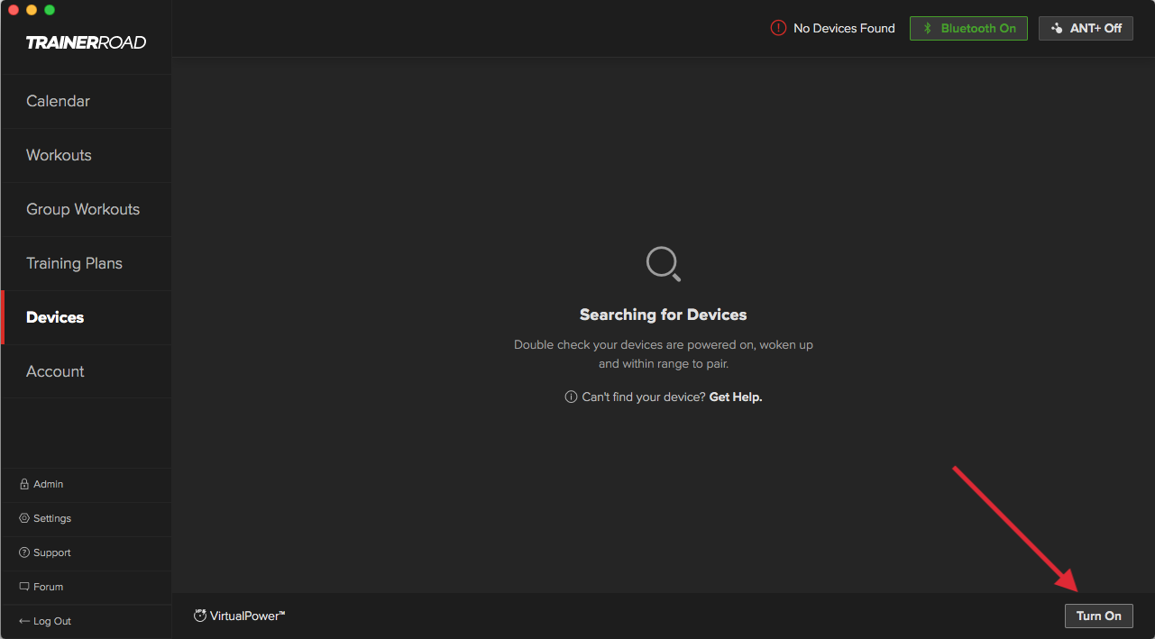

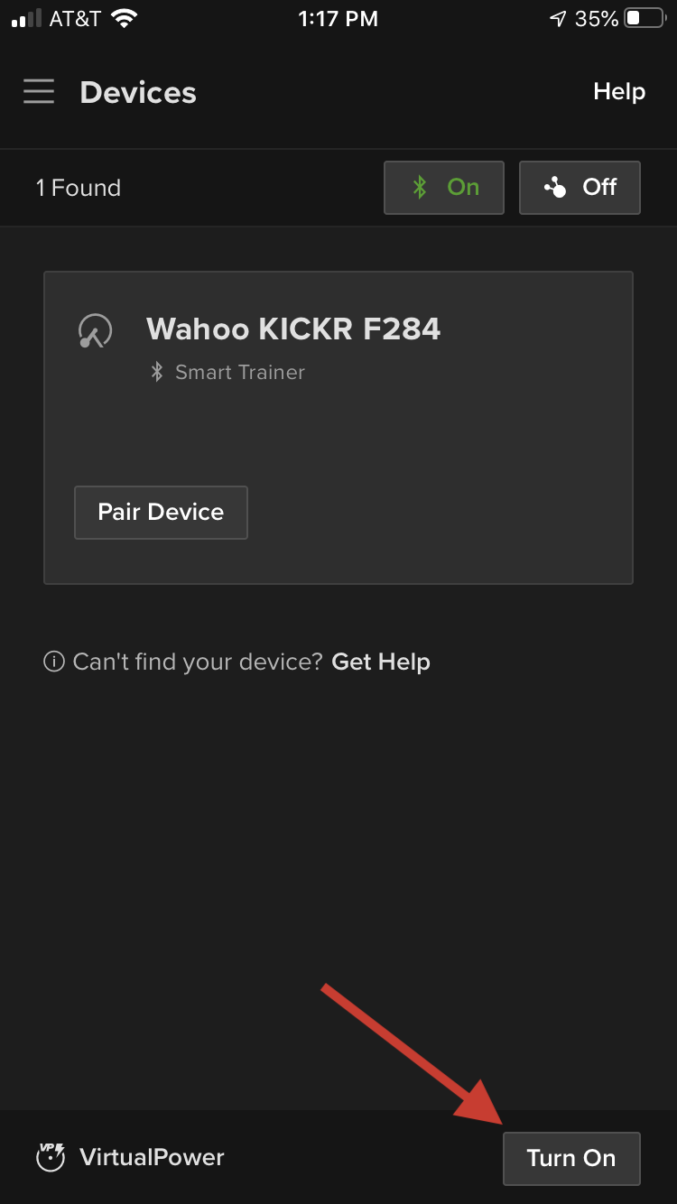

  1. Make sure you have an ANT+ or Bluetooth Smart speed or speed/cadence sensor paired under the devices tab in the desktop software. You can get our software here: www.trainerroad.com/install

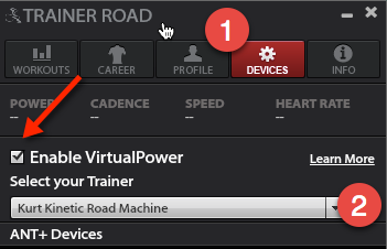

  5. Under the devices tab make sure "Power Source" is set to your trainer.

  1. Make sure VirtualPower is not enabled.
