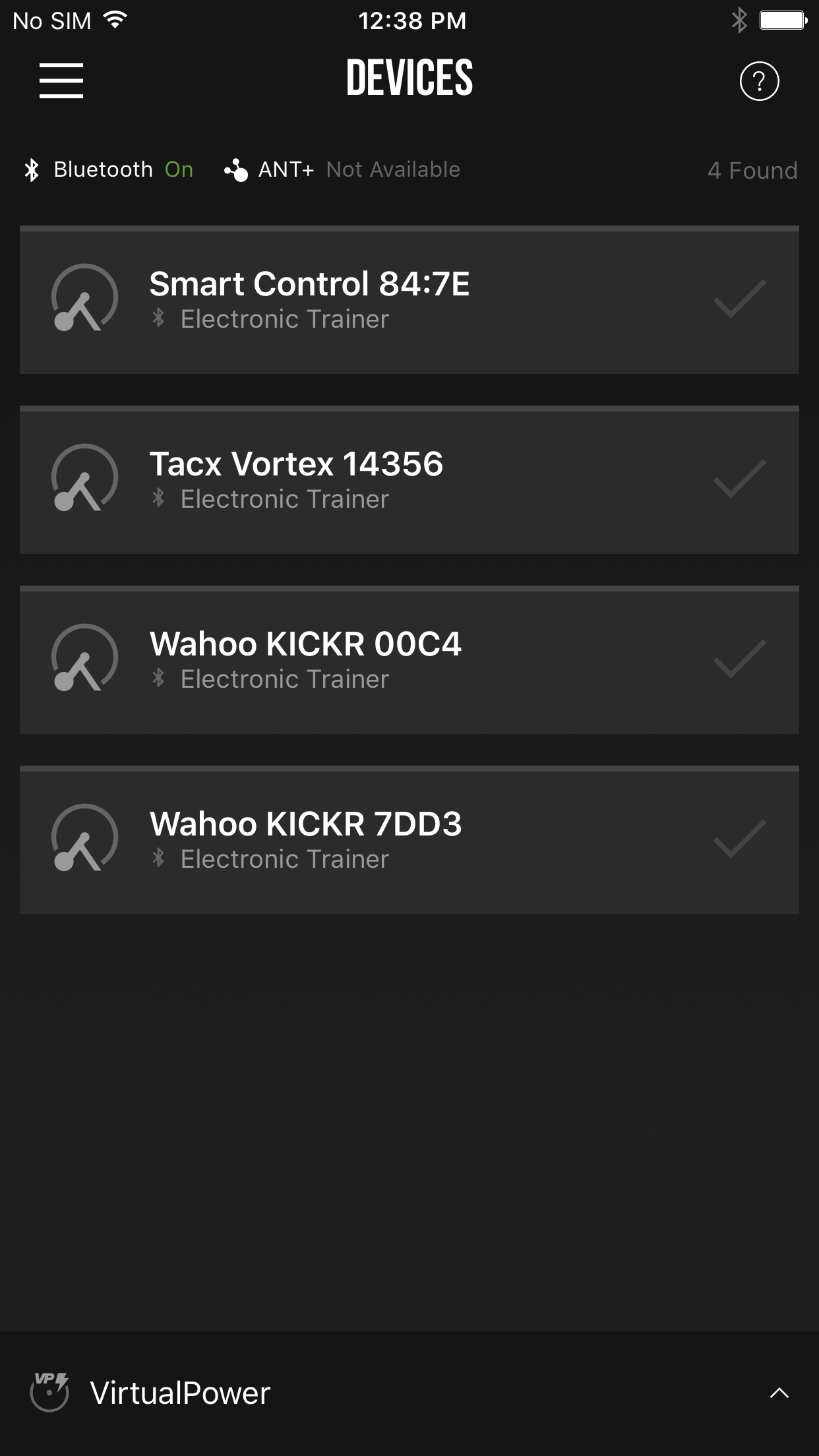

1. Open the TrainerRoad app and go to the Devices screen.
Make sure that either Bluetooth or ANT+ is enabled and your KICKR is plugged in and awake.
2. Tap the KICKR option to initiate the pairing process.

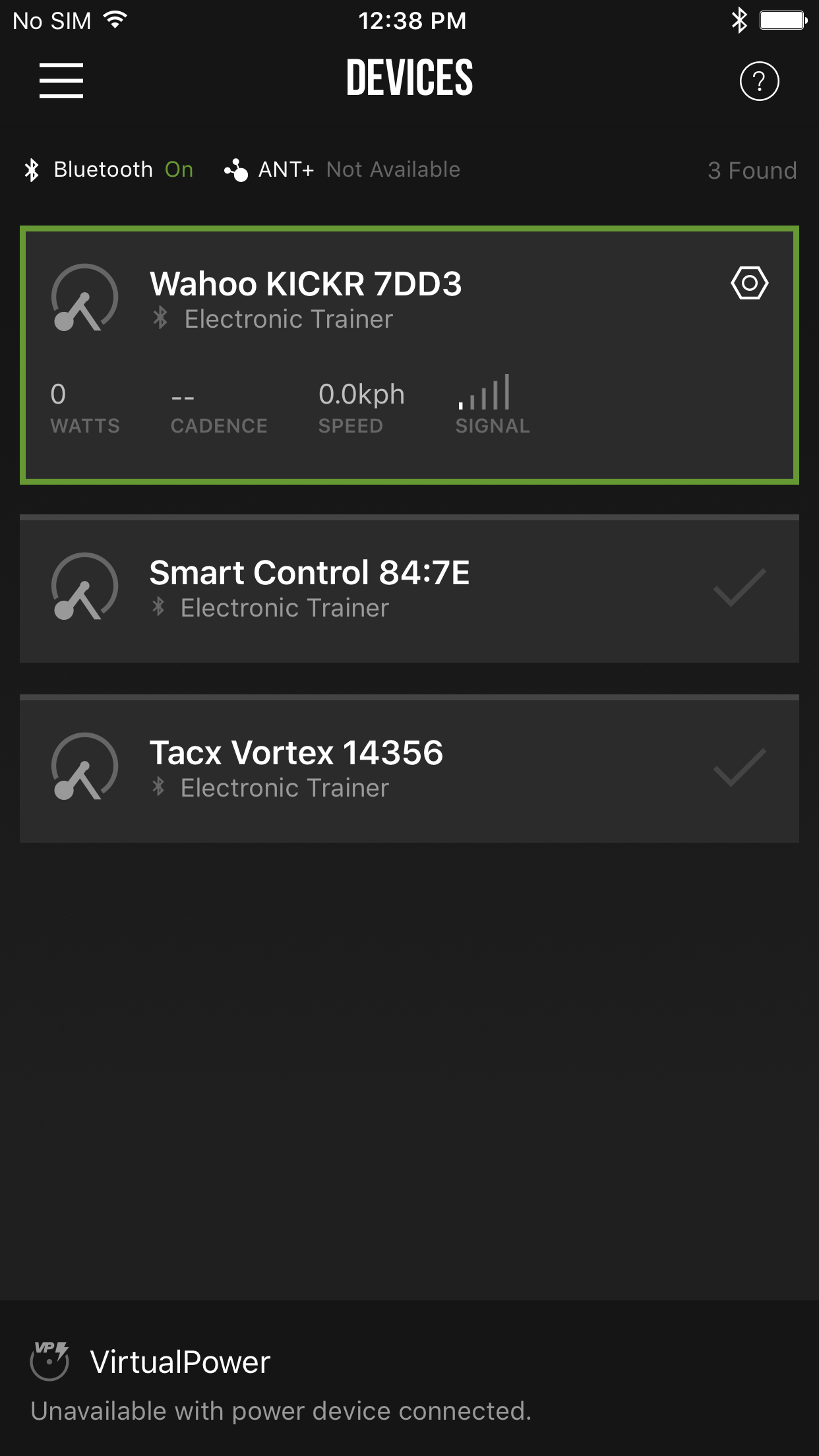

Once paired, the KICKR will rise to the top of the list, bordered in green.

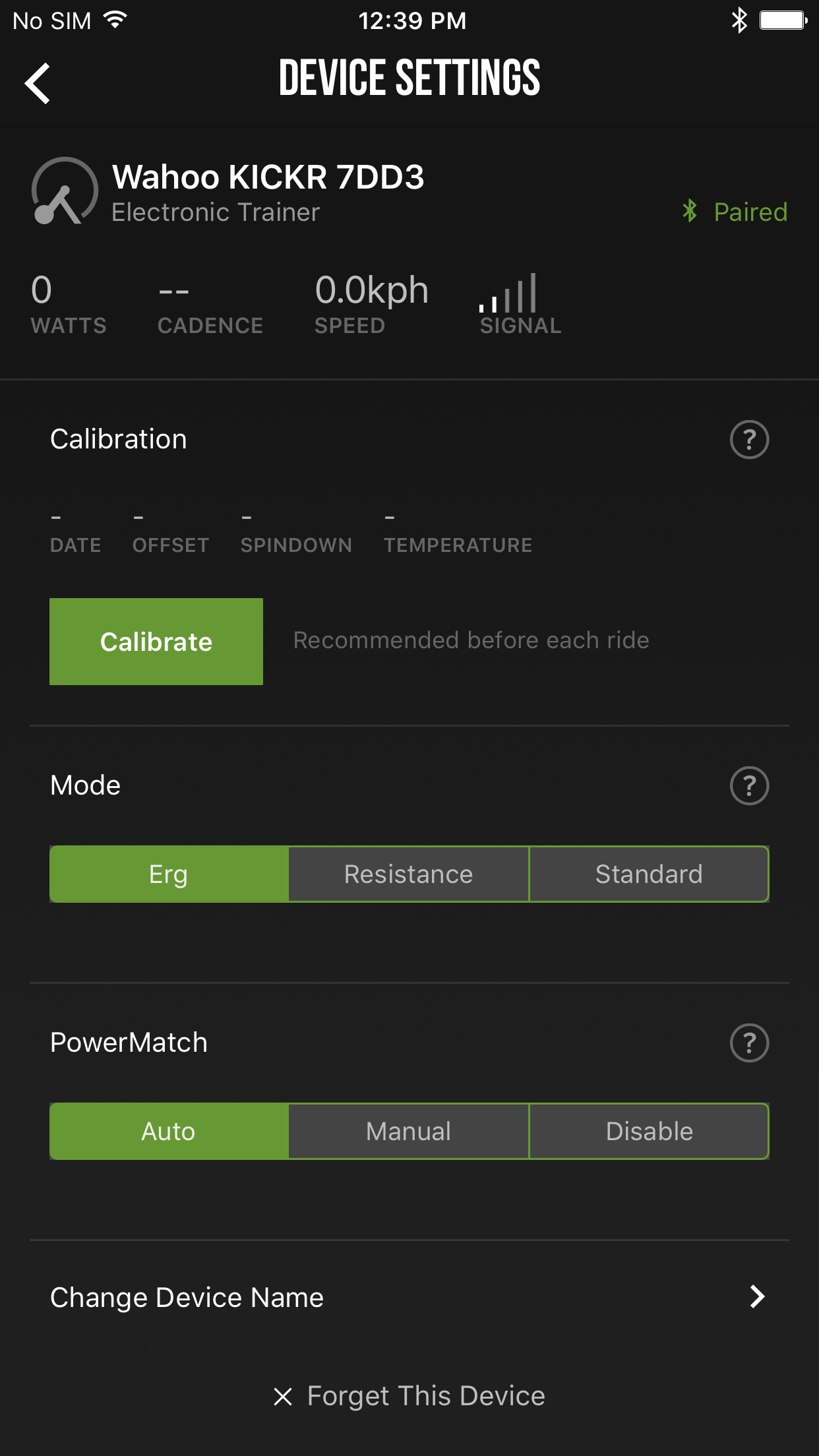

3. Tap the KICKR once more to open the Device Settings screen.
From here, you can perform a spindown calibration, rename the device, select the mode, and specify PowerMatch options.

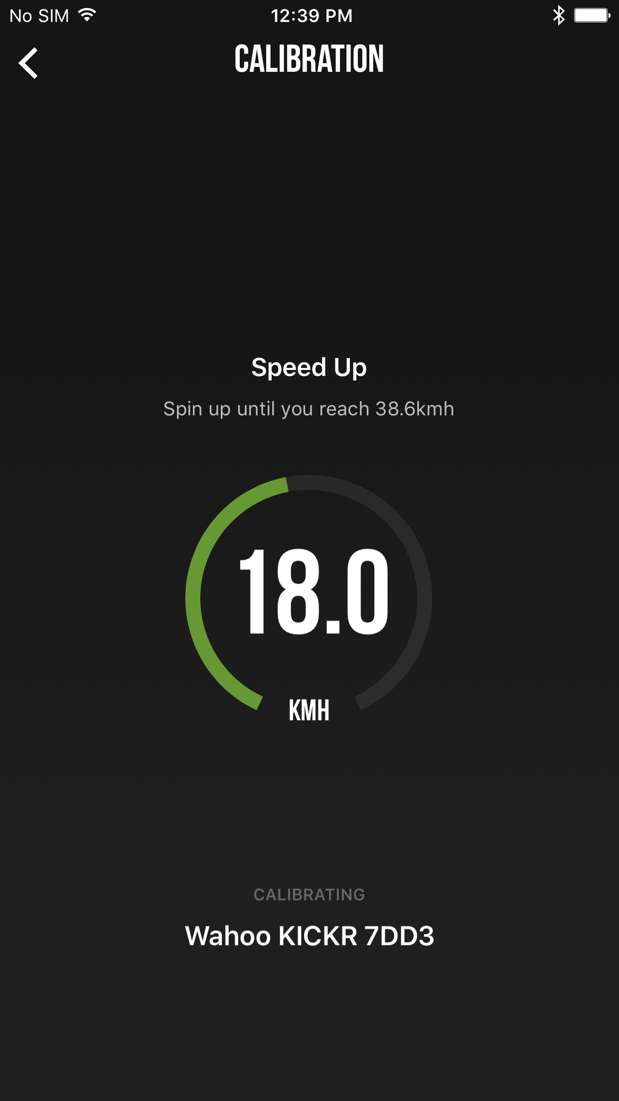

4. Perform a Spindown Calibration.
Tap "Calibration" in the Device Settings screen.
You're now ready to ride!
Note: KICKR v5's and newer models (any model past 2018) automatically calibrate on the fly as you ride. There's no need to calibrate manually with a spindown due to this functionality. You can learn more about this self-calibrating process here.

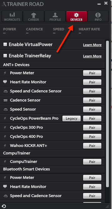

1. Open the TrainerRoad app and go to the Devices tab. Make sure your ANT+ USB stick is plugged into your computer.
Note that you will need a ANT+ USB 2 stick in order to use TrainerRoad's automatic resistance control feature. Learn more about ANT+ connectivity.

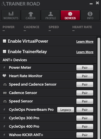

If you don't have an ANT+ stick plugged in, you'll see this:

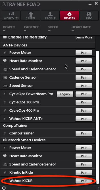

2. Once your ANT+ stick is in, click "Search for ANT+ USB" and you'll see a list of devices you can pair with.

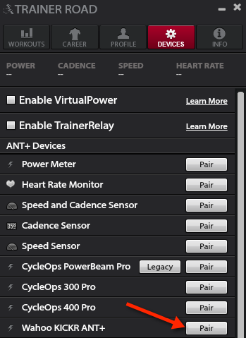

Scroll toward the bottom of this list and you'll see the option to pair your KICKR.
3. Click the Pair button next the Wahoo KICKR.
Make sure that your KICKR is plugged into a power outlet. In order for TrainerRoad to read the KICKR, you may need to get on the bike and begin pedaling to wake the KICKR up.

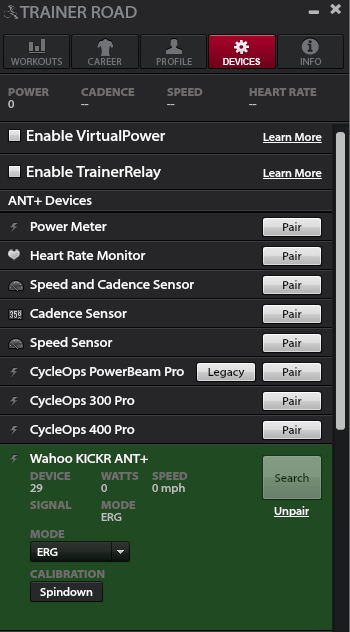

4. Your KICKR is now paired.

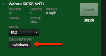

5. Click the Spindown button, and follow the instructions to perform a spindown calibration.
This will ensure your KICKR's readings are accurate.

1. Open the TrainerRoad app, and go to the Devices tab.

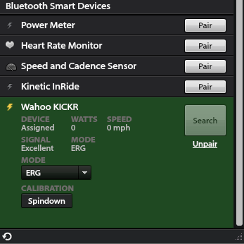

2. Scroll to the Bluetooth Smart Device section, and find the Wahoo KICKR.
3. Click the Pair button, and wait for the KICKR to connect with TrainerRoad.

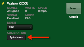

4. Click the Spindown button, and follow the instructions to perform a spindown calibration.
