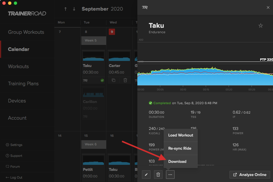

Option #1 (3rd-Party Site via Desktop App):
1. Open the TrainerRoad app and go to your Career tab
2. Find the workout you'd like to download, and click to the right of the workout's thumbnail for more options
3. Click the "Download" button that will appear
4. Upload the .fit file to the third-party (Training Peaks, Garmin Connect, Strava, etc.) of your choice.

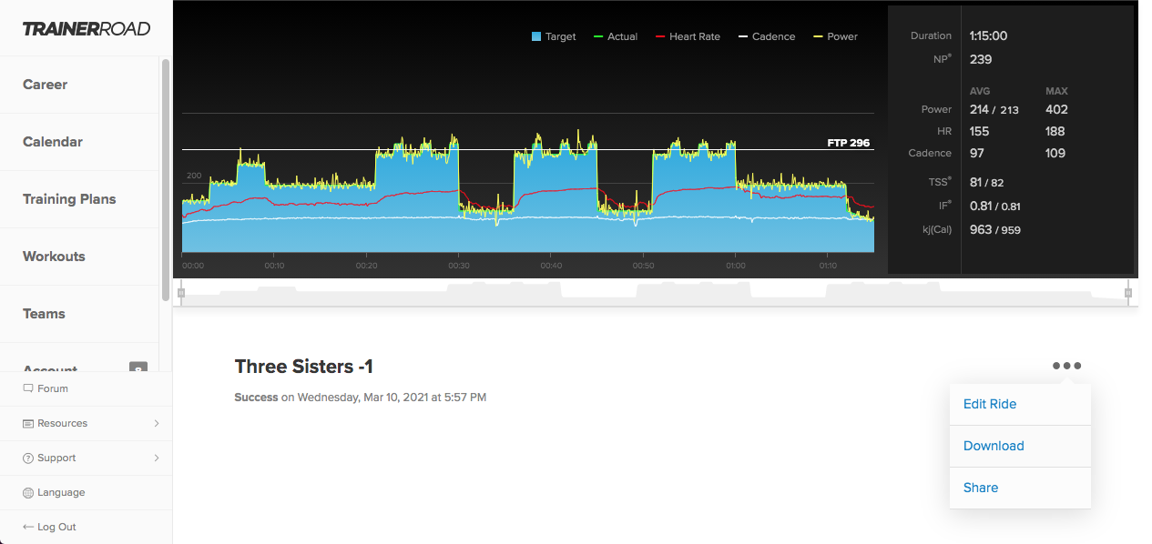

Option #2 (3rd-Party Site via Online Career):
1. Open the workout in your online Career page
2. Click the "Download" button in the upper, right-hand corner of the screen
3. Upload the .fit file to the third-party (Training Peaks, Garmin Connect, Strava, etc.) of your choice.
