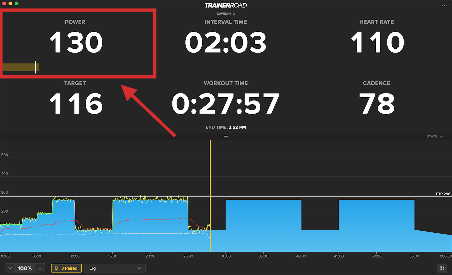

Power Smoothing applies a rolling average of 1-30 seconds to your power data in the data field of the workout player for the interval you are currently in. You can control your Power Smoothing settings from the Settings section of the apps.
Note: Power Smoothing settings do not apply to the actual graph of your power.

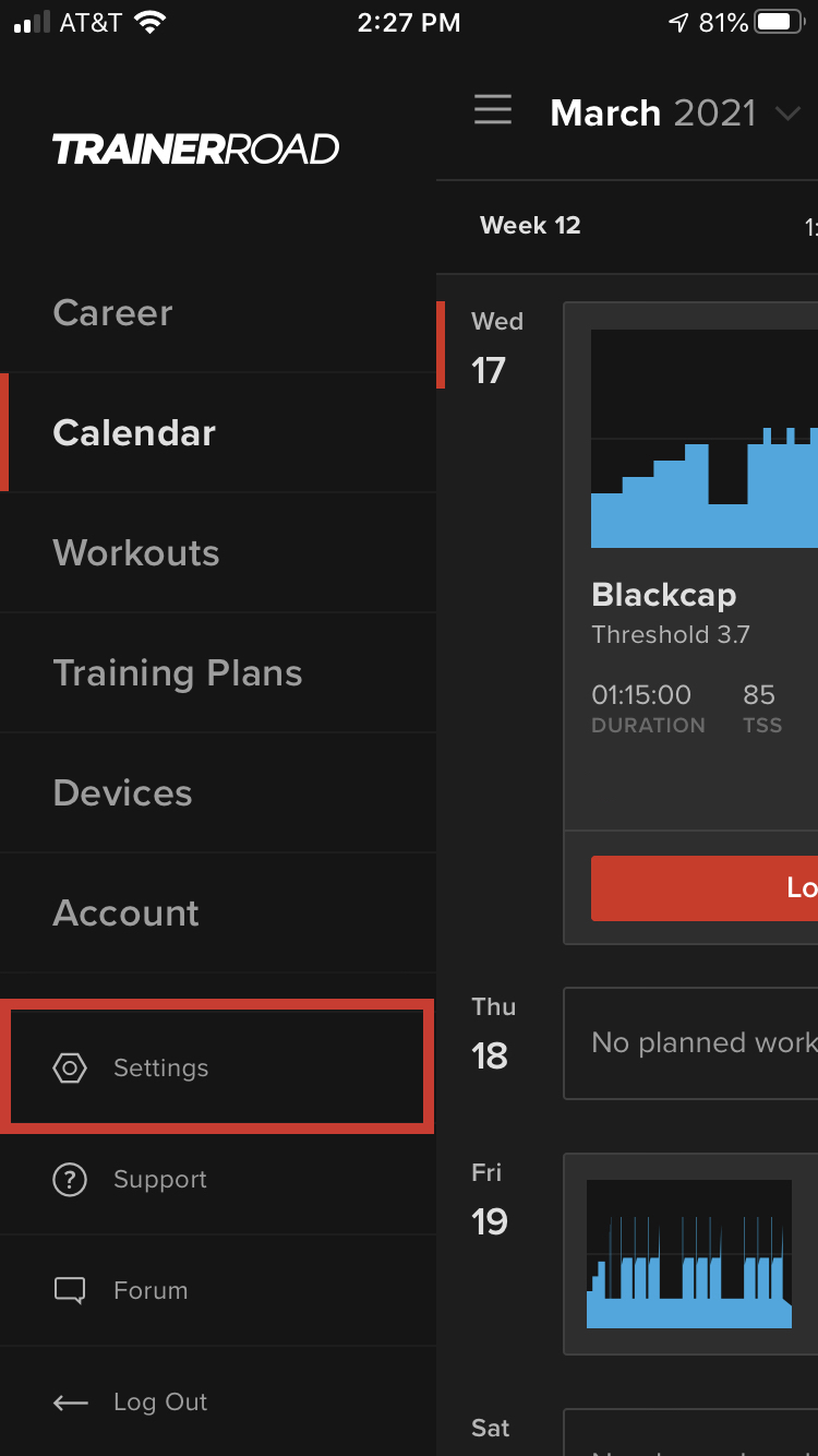

Step 2. From the navigation menu, select Settings

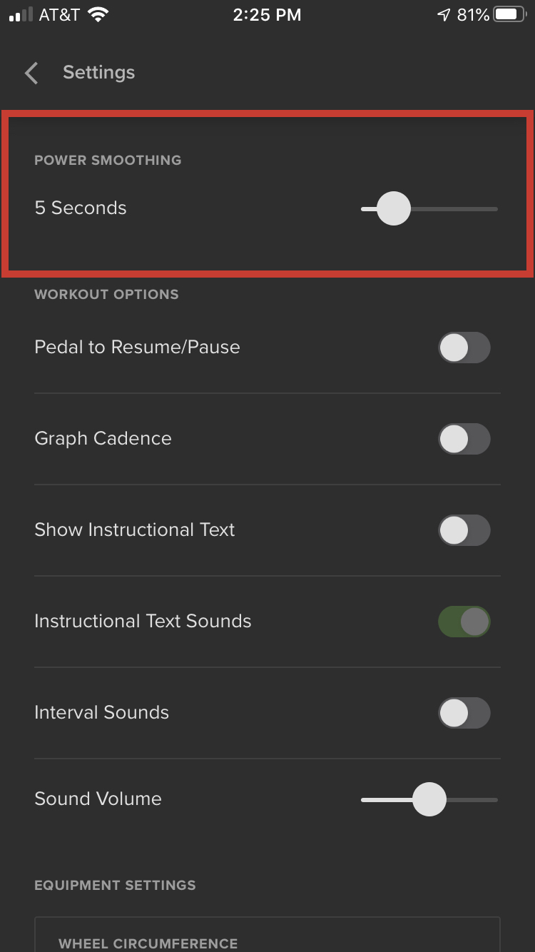

Step 3. Under the Power Smoothing section of the Settings menu, drag the slider to adjust from 0-30 seconds.

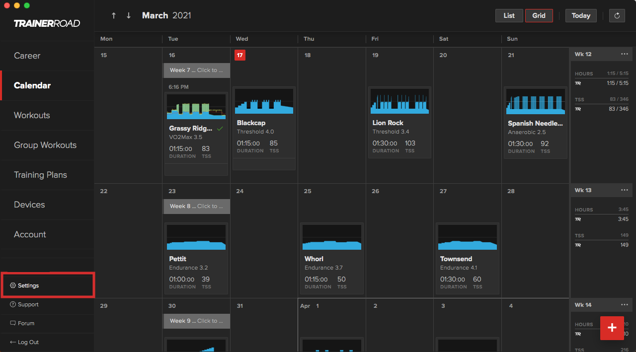

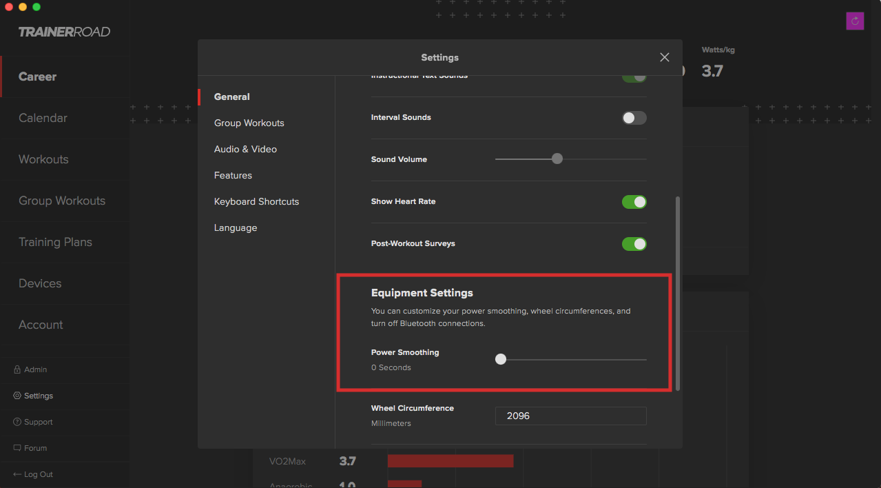

It ultimately comes down to personal preference. The important thing to remember is this only affects the Power section of the data field. This won't smooth the graph of your power.
