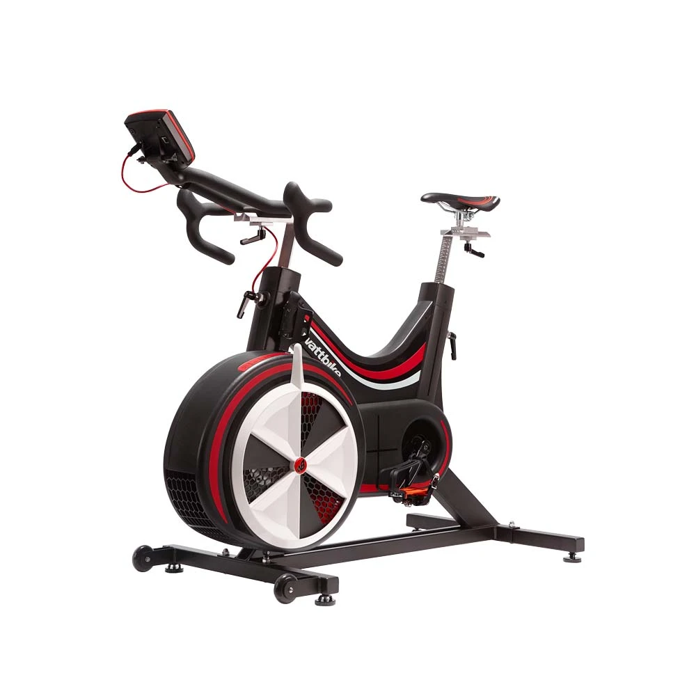

Wattbike Pro

The Wattbike comes with a head unit that broadcasts the data to TrainerRoad. There are two different models of the Wattbike head unit.
  • Model A Monitor - Can broadcast via ANT+ only.  NOTE: Model A Monitor can be upgraded to Model B for a cost if the user sends their old monitor to WattBike
  • Model B Monitor - Can broadcast via Bluetooth or ANT+.  NOTE: Not all Model B Monitors come standard with Bluetooth.  If you have a non-Bluetooth-enabled version, you can upgrade the monitor for a cost.  You will need to send the monitor to WattBike for this, and unfortunately, this service is only available to users in the UK at this time.
