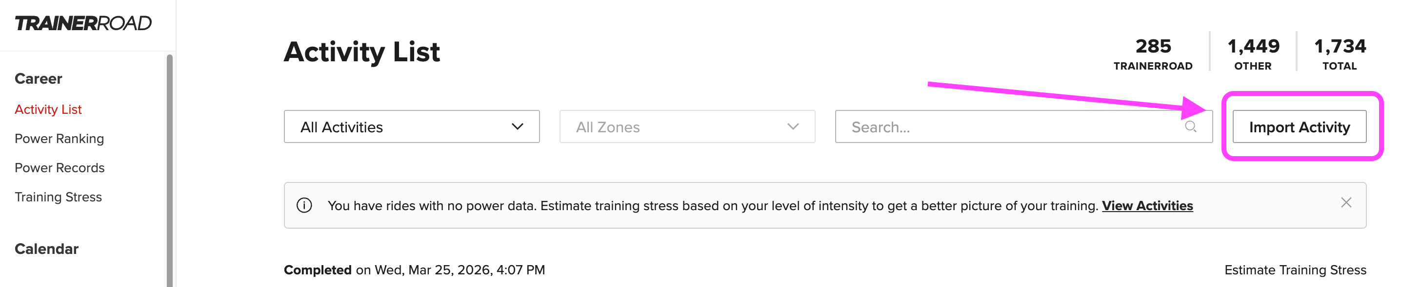

There are two ways to complete an outside workout; file upload and manual completion.
File Upload
Outside workout files uploaded to TrainerRoad will automatically pair with your planned outside workout. Files can be uploaded automatically using Activity Sync, or manually uploaded from the "Import Activity" button on the Activity List in the Career section:
