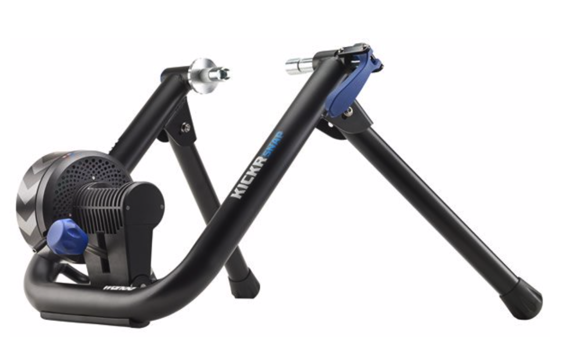

Wahoo KICKR Snap
By Cooper Richardson • Last updated on Aug 13, 2026
The Wahoo KICKR Snap is a smart trainer that connects to TrainerRoad via either ANT+ or Bluetooth Smart. TrainerRoad can automatically control the KICKR Snap's resistance in accordance with the workout's profile. This is a wheel-on trainer that uses its heavy flywheel to deliver smooth power.
