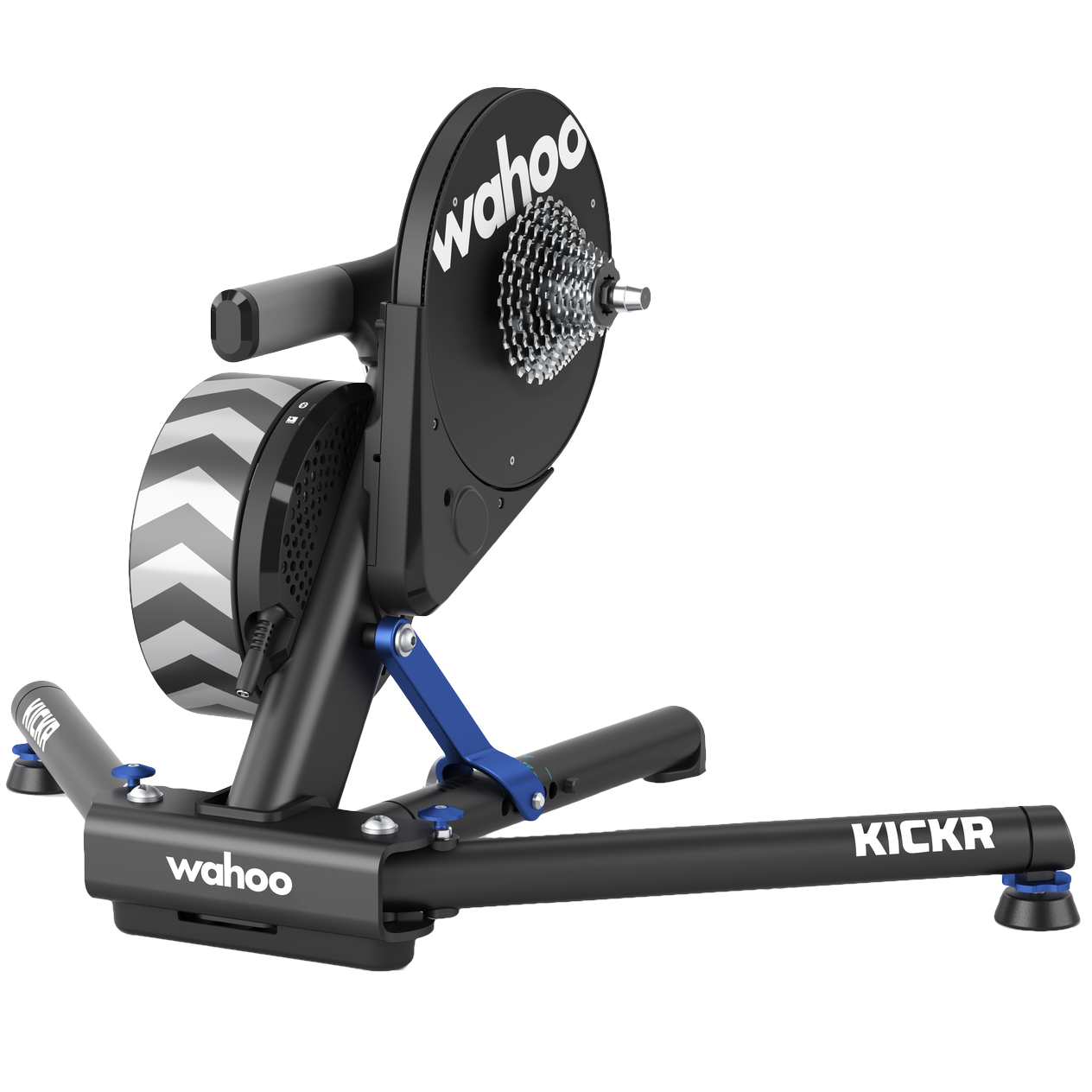

The KICKR, made by Wahoo Fitness, is a direct drive smart trainer that uses automatic resistance control (ERG mode) to seamlessly match your power output to the prescribed power of your TrainerRoad workout. Its heavy flywheel provides a smooth power output as you ride to give you a true road feel.

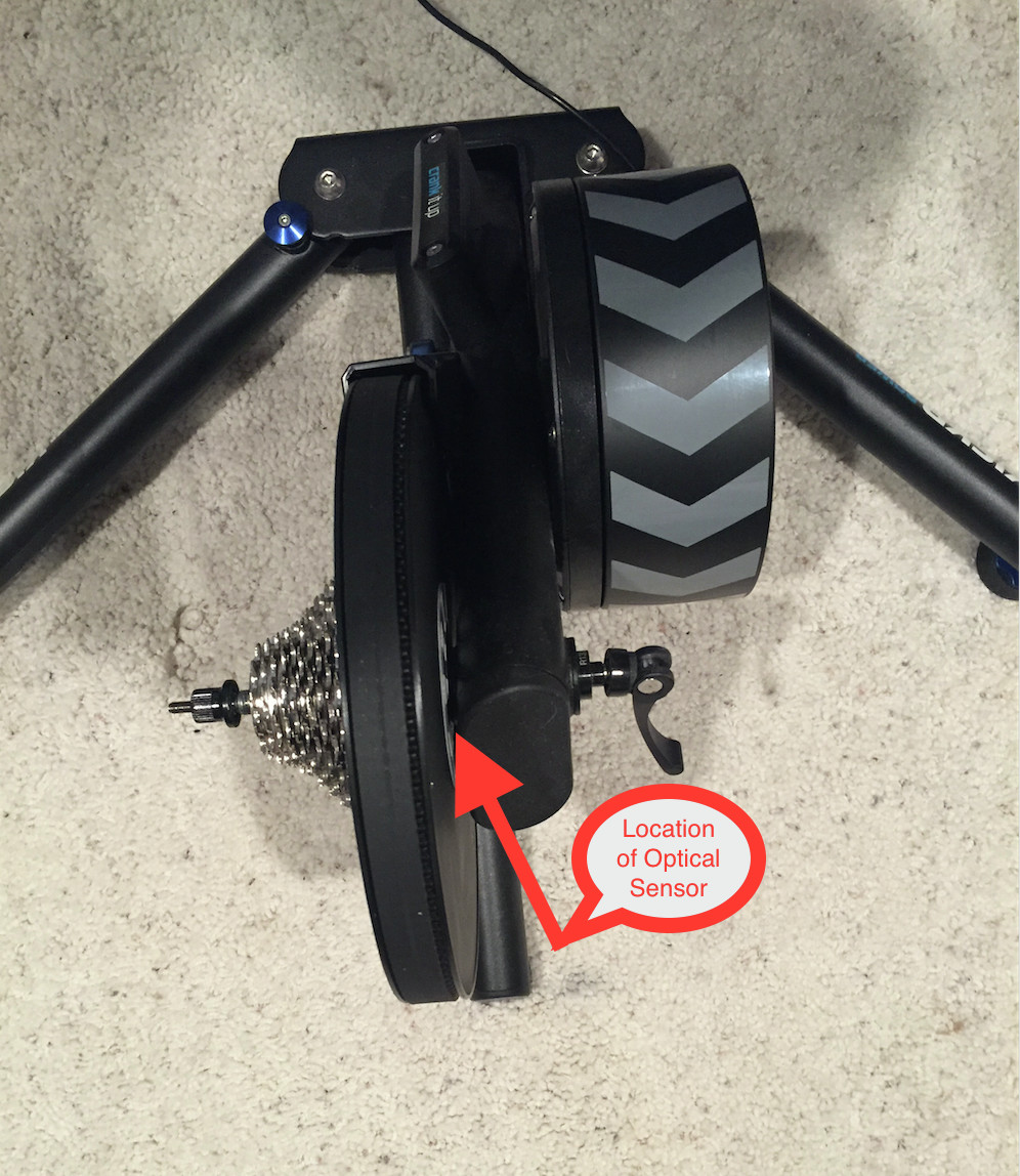

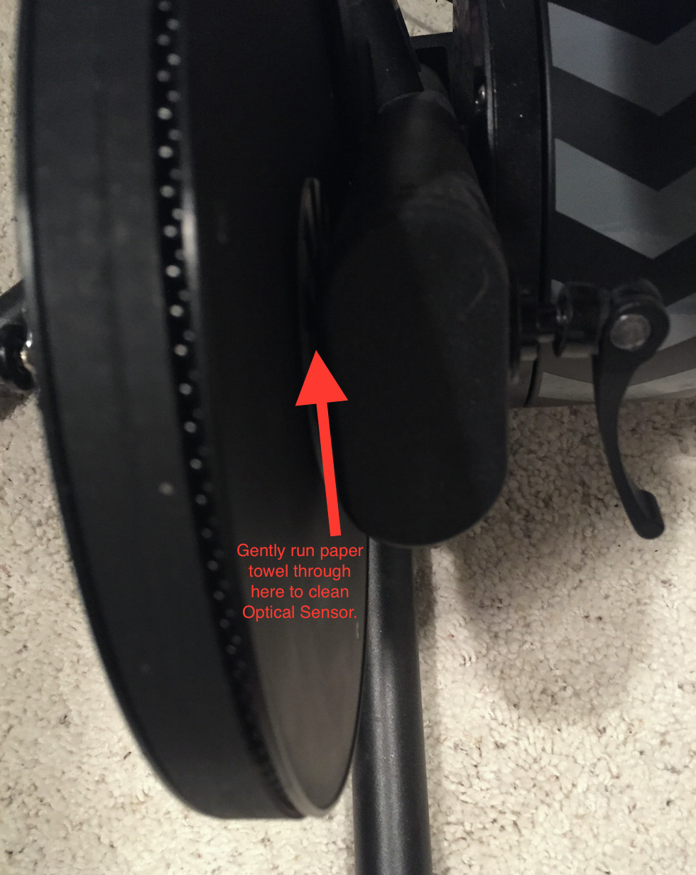

Erratic Power Values and Dropouts: Generation 1 KICKR Only
- If you're using a generation 1 KICKR (notice it does not have a handle and it has a zebra pattern opposite the cassette) and you're experiencing wildly fluctuating power, or a continual dropout, you may need to clean your optical sensor.
To clean the optical sensor, gently rub a paper towel through the area shown below.
