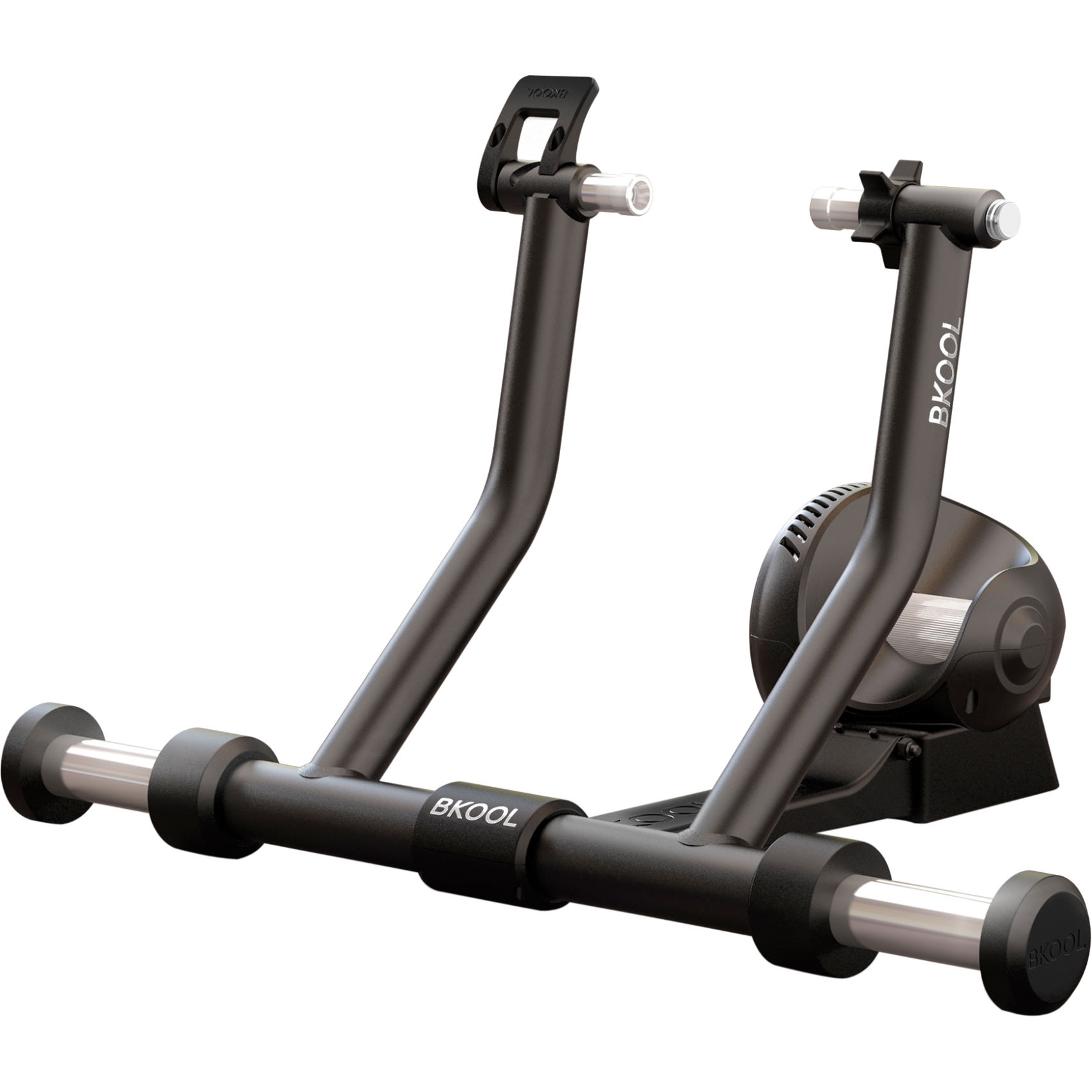

The Bkool Pro is an electronic, wheel-on trainer that uses an electromagnetic system to automatically control resistance during your workouts.
