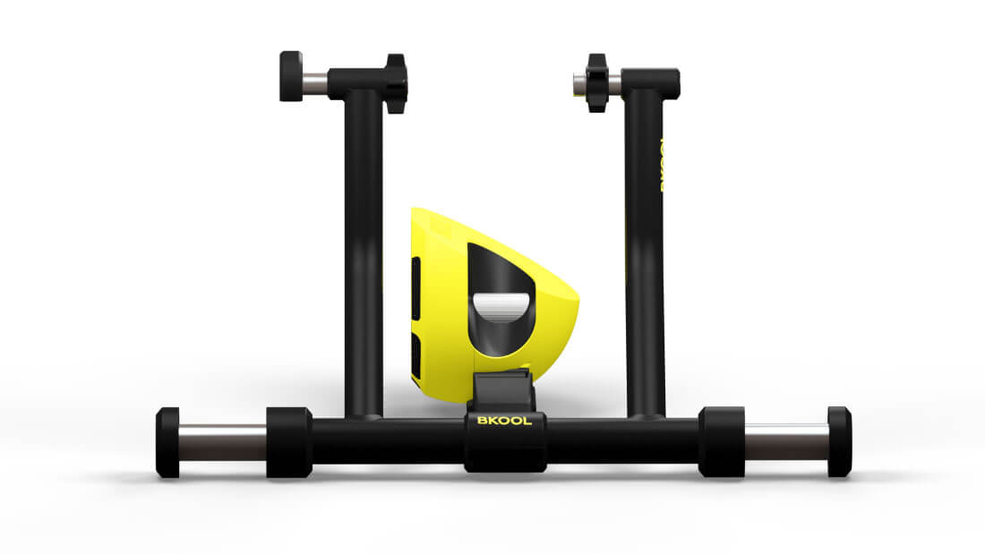

Bkool Pro 2
The Bkool Pro 2 is an electronic, wheel-on trainer that uses an electromagnetic system to automatically control resistance during your workouts.
First thing’s first! Make sure you’ve downloaded the TrainerRoad app here.
