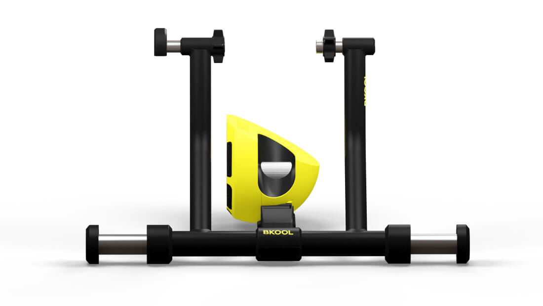

The Bkool Pro 2 is an electronic, wheel-on trainer that uses an electromagnetic system to automatically control resistance during your workouts.
